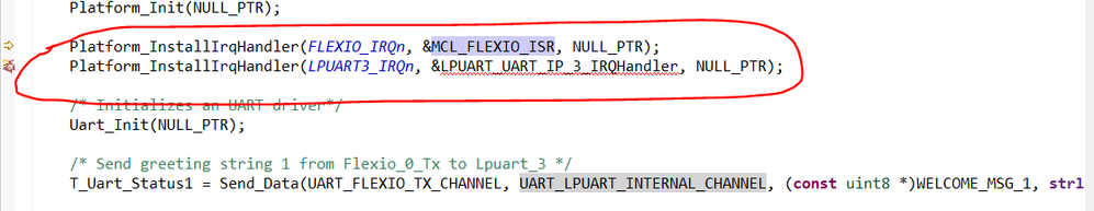

Thank you for the quick response. I have tried the the UART example by compiling in Debug_RAM and run it with same. The pll clock and HardFault issues was resolved, but the execution going to undefined _handler from the Uart_AsyncSend().

namnguyenviet
Hello @kranthi,
Turned out the interrupt handlers haven't been installed yet. Please add these lines after PlatformInit(NULL_PTR):
Platform_InstallIrqHandler(FLEXIO_IRQn, &MCL_FLEXIO_ISR, NULL_PTR);
Platform_InstallIrqHandler(LPUART3_IRQn, &LPUART_UART_IP_3_IRQHandler, NULL_PTR);
After adding these, I can run the example normally.
Nam

kranthi
Hi @namnguyenviet
Thank you for the support. yes, after adding the two interrupt handler lines the application is working fine. But if we want to Debug in Debug_Flash mode what we need to configure/change?
