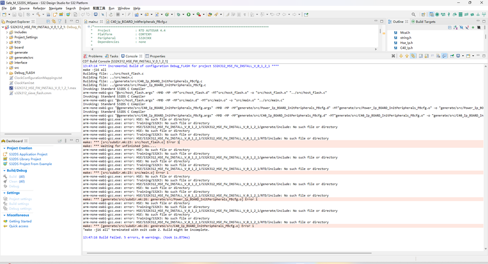

After decompressing the official project, there is a compilation error.
How should I do?

This is an outdated example based on S32K3_RTD_1_0_0_HF01_D2111. You need to use S32DS.3.4 with S32K3 Real Time Drivers Version 1.0.0 HotFix 01 installed to compile it.
Considering that you are a Chinese customer, it is recommended to ask Distributor FAE for the latest s32k3_hse_lib_rtd400hf01_20250221.7z which contains the project for installing HSE FW for S32K312.
