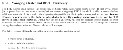

It says in your referred text that the MemAcc driver will handle any IVOR exception that is thrown during startup. Is this something that needs to be set up explicitly?
3,520件の閲覧回数
lukaszadrapa
Hi @ola_gook
this is common situation and the drivers take this into account. From user manual:
Lukas

So what could be the reason for it not to work in my specific case?
