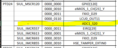

I am trying to set ADC port bits (SSSS) in the SIUL2 using the MSCR register, however I am not finding the necessary information. Is ADC set up differently that other port peripherals such as eMIOS?
Thank you!
Vusal

You don't need to configure SSS due to those analog function are Direct Signals. Refer to the discussion in s32k3 configurations pin
Robin
