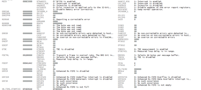

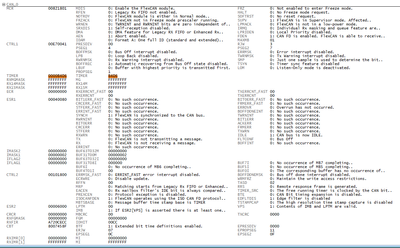

Kazarian
Register view
Kazarian_0-1732202037182.pngKazarian_0-1732202037182.pngKazarian_1-1732202074231.pngKazarian_1-1732202074231.png

Senlent
Hi@Kazarian
This may be related to the number of MB settings you have.
Please provide a complete demo if you encounter problems.

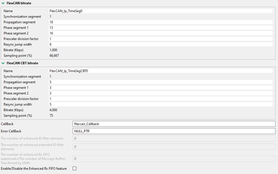

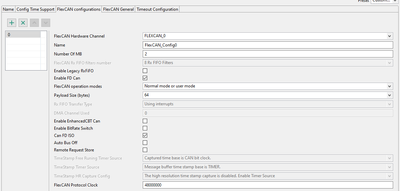

Kazarian
Hello @Senlent
i emailed you the code in private message.
Number of MB is 2, below is the configuration.
Thank you.

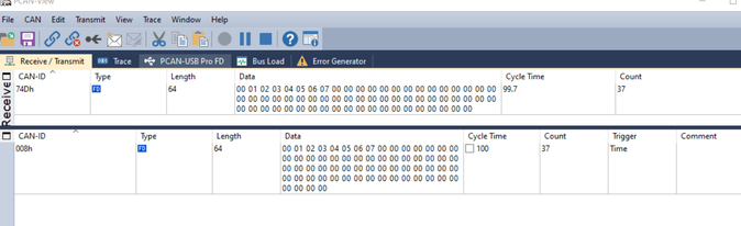

Kazarian
Hello @Senlent
Thanks a lot for your answer,
The MCU goes to hardfault when i send a can frame from my CAN-Case into the MCU.
i can however send frames from MCU to my Canoe.
i want to set a range of ids not only 1, and im using CAN-FD with 64 bytes, here is init function, can you please update the RX filter and also why the MCU hard fault ?
between im using Freertos i dont know how usefull this info can be !
