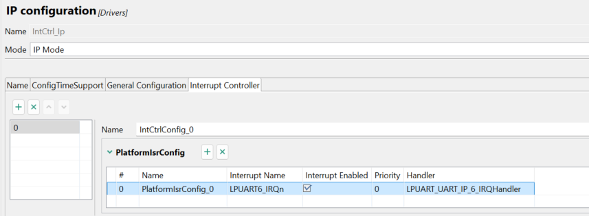

PetrS
if you want to use driver's interrupt routine and call own callback from it then just configure respective handler in IntCtrl component (here lpuart 6 is shown, use your instance) and add your callback function in Lpuart component
2025-02-07_11-43-35.png2025-02-07_11-43-35.png2025-02-07_11-43-57.png2025-02-07_11-43-57.png
Then in your code you add callback and do your need according available events
void Uart_Callback(const uint8 HwInstance, const Lpuart_Uart_Ip_EventType Event, void *UserData)
    if(HwInstance == UART_INSTANCE)
    	switch(Event){
    	case LPUART_UART_IP_EVENT_RX_FULL:
    		break;
    	case LPUART_UART_IP_EVENT_TX_EMPTY:
    		break;
    	case LPUART_UART_IP_EVENT_END_TRANSFER:
    		break;
    	case LPUART_UART_IP_EVENT_ERROR:
    		break;
    	case LPUART_UART_IP_EVENT_IDLE_STATE:
    		break;
    	default:
    		break;
BR, Petr

PetrS
the LPUART_UART_IP0_IRQHandler is assigned nowhere so there is no reason to be called.
1) the Lpuart_Uart_Ip_EventType enum of the Events which can trigger UART callback is defined in lpuart_uart_ip_types.h.
Teh callback with LPUART_UART_IP_EVENT_RX_FULL event is called when defined number of bytes (specified in AsyncReceive function) was received.
2) the LPUART_UART_IP_0_IRQHandler is driver ISR routine assigned for module interrupt. When byte is received/send this handler is called, byte serviced and user callback is called from there if defined event is achieved.
3) you can check in debugger if driver interrupt is get, means LPUART_UART_IP_0_IRQHandler called. if yes then LPUART_UART_IP_EVENT_RX_FULL would be called as well after defined number of bytes is received.
BR, Petr
