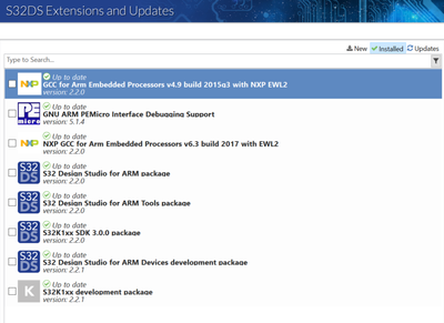

Attached a picture of my Design Studio view. I use Design Studion v2.2 and these are my extensions:
7 Replies

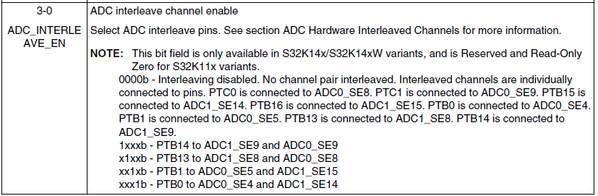

danielmartynek
Hi @Maijaaah,
PTB14 can be connected to ADC1_SE9 or to ADC0_SE9 or both at the same time.
By default, PTB14 is connected to ADC1_SE9.
So you can either connect the pin to both ADC modules in SIM_CHIPCTL[ADC_INTERLEAVE_EN] or you can use ADC1.
