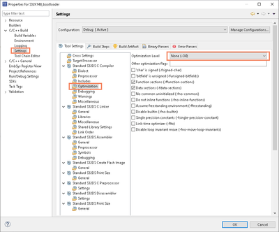

it could be caused by optimizations. I would check if the optimization level is set to 0:
Lukas

Currently we have zero optimisation's, Am able to break it in few trials as it is random.
