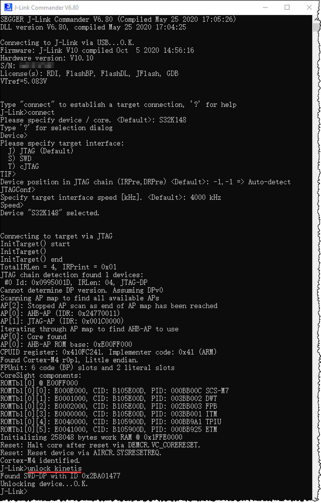

Would you please show the image of "unlock kinetis" in J-Link Commander?
If Mass erase is enabled, you should be able to "unlock kinetis" in J-Link Commander.

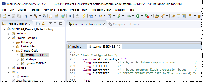

Have you modify the value of Flash Configuration?

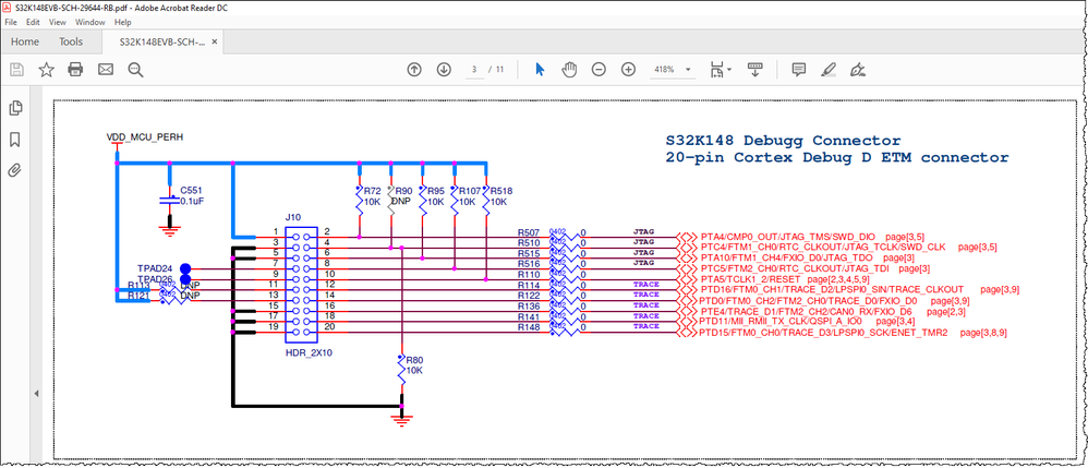

Please check the connection between S32K148 and J-Link. Are you using S32K148EVB or custom board?

         First of all, I finished the "unlock kinetis",and it showed "OK".Then, I do not know the Mass erase is enabled or not.If Mass erase is disabled,what should I do.At last, the connection between S32K148 and J-Link is OK,and the schematic diagram is the same as yours.Looking forward to your reply.

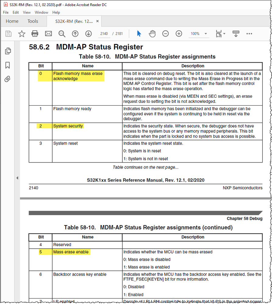

For more information about the register please refer to Section 56.6 MDM-AP status and control registers, S32K1xx MCU Family - Reference Manual (REV 12.1) .
You should be able to see if the MCU secured (Status[2]), if the Mass Erase operation is enabled (Status[5]) and if the Flash memory is ready (Status[1]).

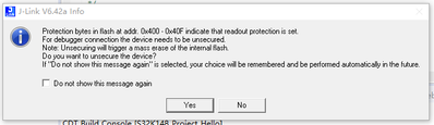

i've facing the very same problem.
Suddenly S32DS started to give a pop-up to unsecure the device.
I've tried many things, emergency recover with kinetis, nothing
Changed my openSDA from PEMicro to Segger
Tried to do this mass erase j-link and the suggest and after that I can't connect or I'm doing wrongly
