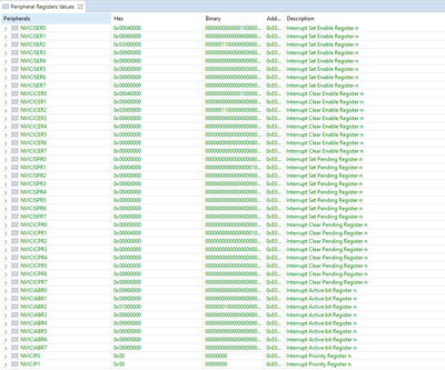

elb1
I added this code and when i send message to the mcu it will come to this function and the value of "g_active_vector" is "104"
void DefaultISR(void)
/* Capture the active vector number from SCB->ICSR register */
g_active_vector = (S32_SCB->ICSR & S32_SCB_ICSR_VECTACTIVE_MASK) >> S32_SCB_ICSR_VECTACTIVE_SHIFT;
while (1)
__asm("nop");
I also inspected SCB and NVIC registers, when the program jump to default isr:
SCB->ICSR -> 0x0440F868
For the NVIC register ISER, ICER you can see the capture attached and for the IP they are all set to 0x00 except NVICIP88 NVICIP89 they are both equal to 0x50
505 Views
