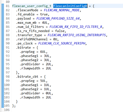

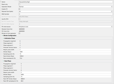

Hi NXP team:
I use S32DS 3.5 to configure the CAN FD as below show:
I just receive the message 1M/5M, but I can not receive it. But when I change my sending machine to 1M/1M   or  5M/5M,  I can receive the message!!!!

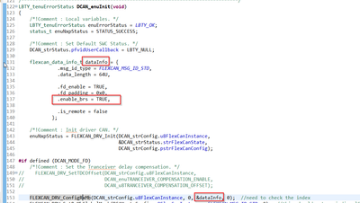

it looks like my BRS  setting is not working. but I confirm I set it as below show:
are there something I miss or I set something wrong???
