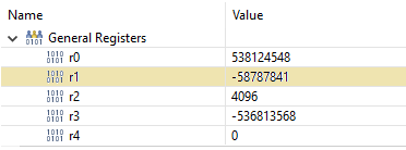

Following are the contents of r1 and r0.
8,714 Views
lukaszadrapa
Value in r1 is definitely not correct, -58787841 in hex is 0xFC7EF7FF which falls somewhere to peripheral address space. I would check content of flash at 0x1000. The application is obviously not programmed correctly.

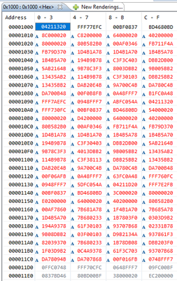

After flashing the application through utility, Following are the values at 0x1000.

I am not getting any clue why the value of r1 is coming negative...
At 0x1000 location some data is written, but yet it is not jumping to application.
In which direction should I proceed?
