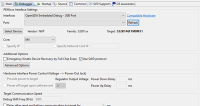

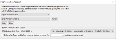

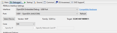

An error occurs when starting debug:
"Port" parameter in PEMicro interface setting is blank
Here is the PEMicro SDA info (when mounted as  /S32K146EVB) :
Board Name is: S32K146EVB-Q144
MicroBoot Kernel Version is: 1.08
Bootloader Version is: 1.13
Installed Application: PEMicro S32K146EVB-Q144 Mass Storage/Debug App
Application Version is: 1.21
DUID is: 4C933938-3EF581E2-375B1811-E55FE678
EUID is: 4611A239-B057876C-185A3A16-076868D6
TUID is: 74823938-47328196-8467AE18-C23C9852
TOA is: 86B6E505-805DF688-79B2A114-8238FC42
TOA2 is: 86B6E505-951FF941-AF6E54B6-9297829E
SUID is: 86B6E505-5BA18877-37239804-8003EC65
S32k146 MCU is normally worked and can be programmed by Segger J-link
Thanks in advance
Andrey Kalinin

Robin_Shen

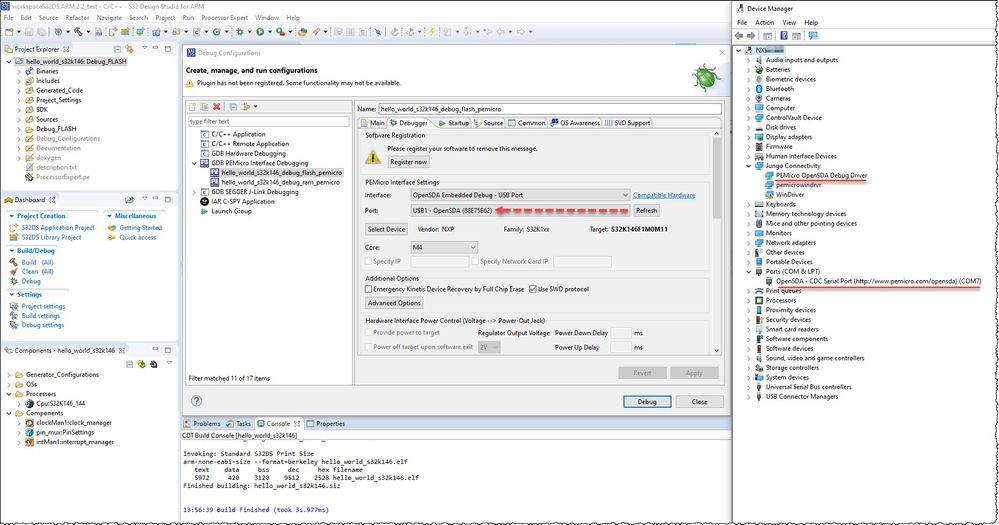

Have you checked the OpenSDA is correct installed? You should be able to see it in Device Manager and able to select in S32 Design Studio.

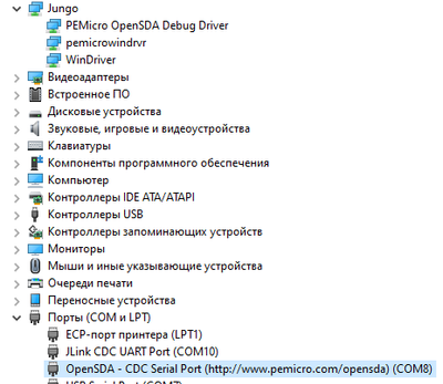

AndreyKalinin
9,488 Views

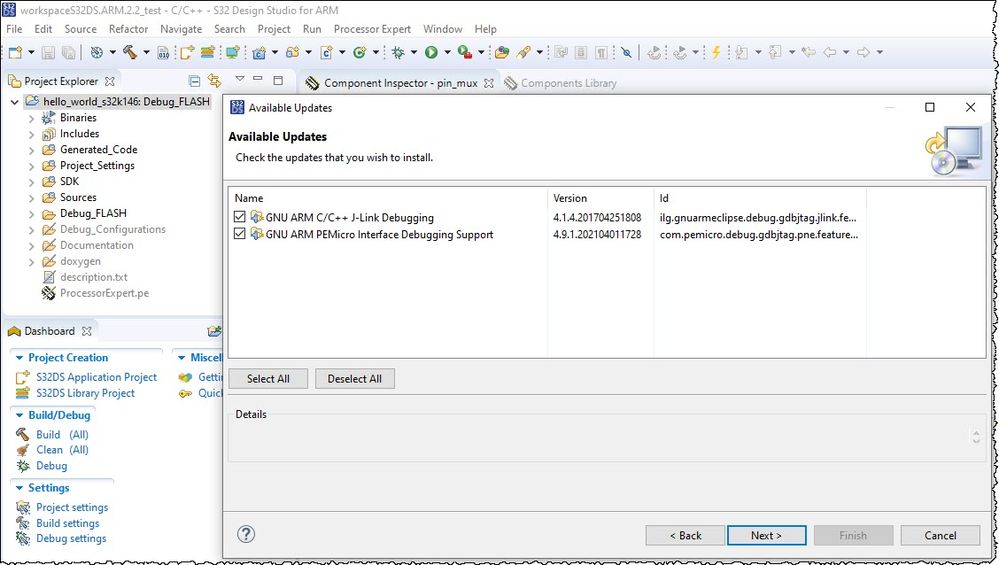

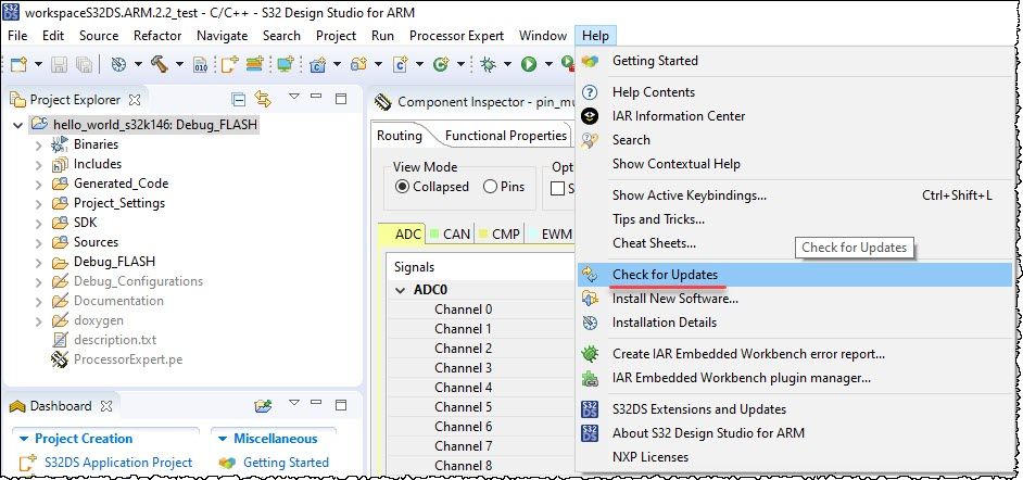

It is strange that your S32 Design Studio does not recognize the OpenSDA debugger interface. Please try to update it in IDE.(It should be installed by default)
Help Check for Updates.jpgHelp Check for Updates.jpgUpdata PEMicro Interface Debugging Support.jpgUpdata PEMicro Interface Debugging Support.jpg

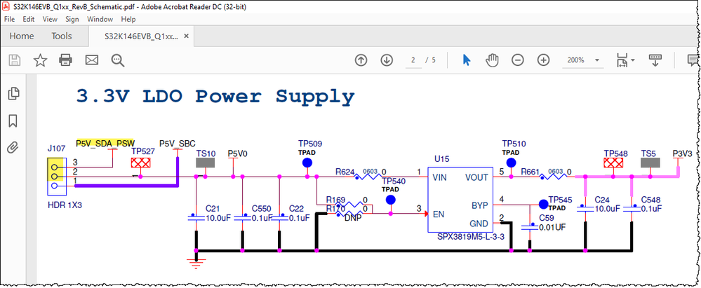

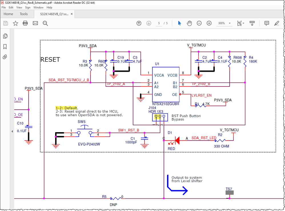

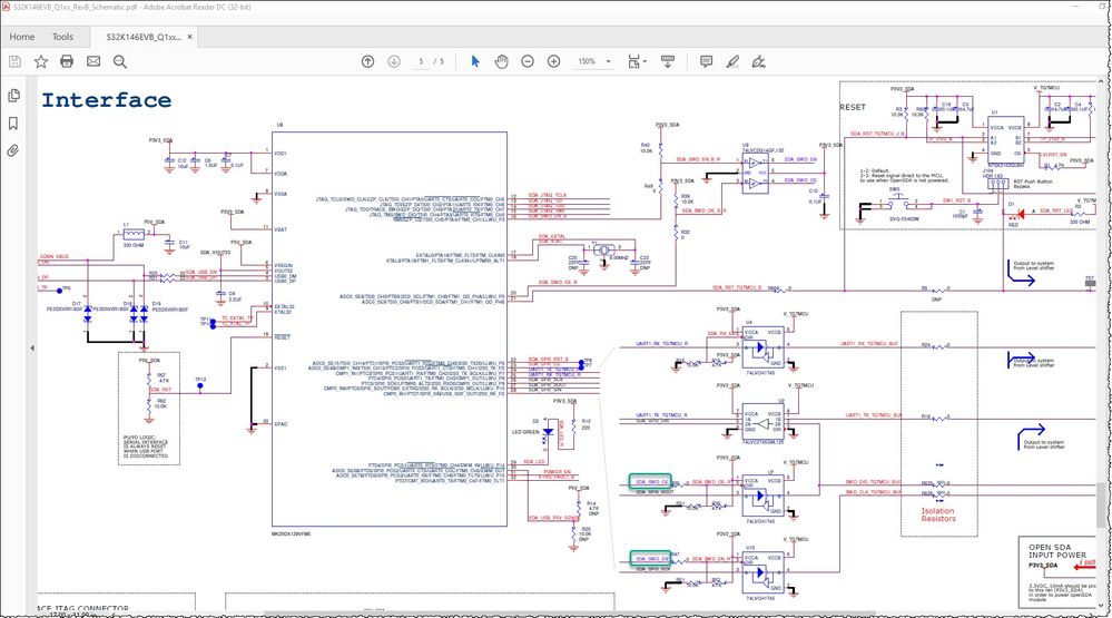

But you can try to check the SDA_SWD_OE\SDA_SWD_EN signals. Mainly check the signals on the OpenSDA Interface page.

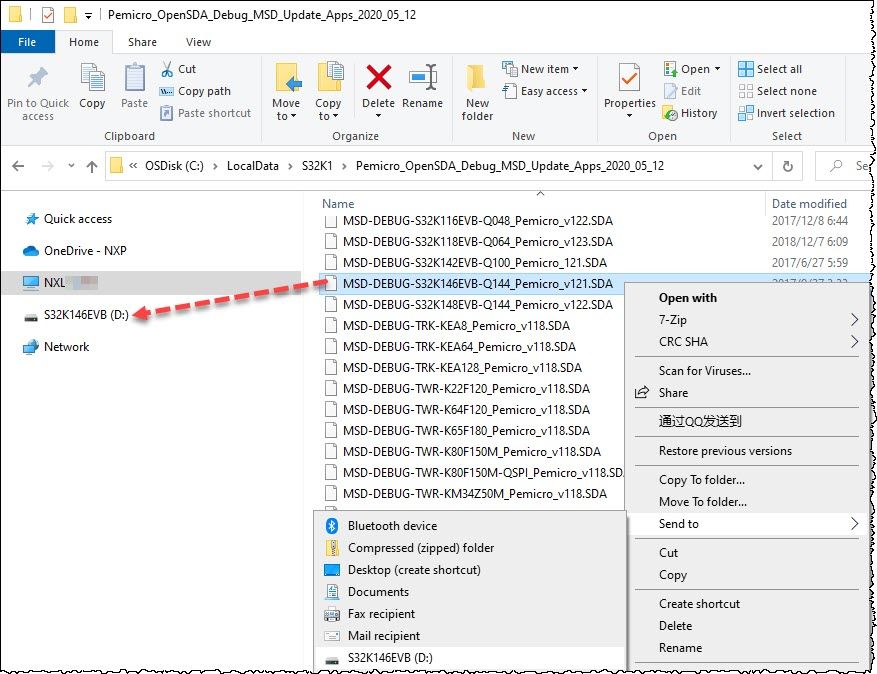

Drop MSD-DEBUG-S32K146EVB-Q144_Pemicro_v121.SDA into S32K146EVB should instill firmware.
MSD-DEBUG-S32K146EVB-Q144_Pemicro_v121.SDA.jpgMSD-DEBUG-S32K146EVB-Q144_Pemicro_v121.SDA.jpg

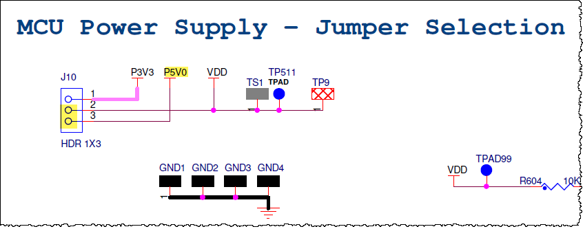

You need to connect pin 1-2 of J104 for S32K146EVB.
Make sure you have load correct OpenSDA firmware and check the default power jumper connection.
J107 23 S32K146EVB.pngJ107 23 S32K146EVB.pngJ10 23 S32K146EVB.pngJ10 23 S32K146EVB.png

You need to connect pin 1-2 of J104 for S32K146EVB.(Image shows you connect 2-3 of J104.)
Please make sure that the power supply mentioned above is correct.(POWER_EN\P5V_SDA_PSW\V_TGTMCU)
