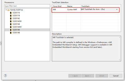

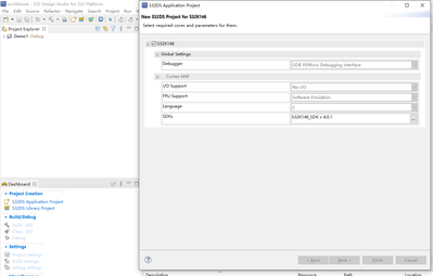

MY  compilation environment is S32DS.3.5

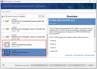

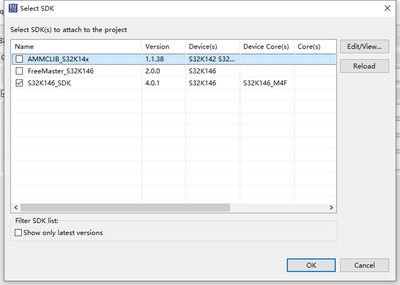

This is my SDK and development package
ToolClian :
SDK:
Click on finish and it freezes

Hi @silversun
There have been some reported issues with S32K1's SDK support in S32DS v3.5, so we recommend for the S32K1 family use the S32DS v3.4. hich has support for the latest SDK (4.0.3) version available. Also, SDK version 4.0.1 was developeed to work with IAR compiler up to v8.11.2.
Sorry for the inconvenience.
BR, VaneB
