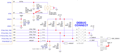

I'm investigating the same fault list for S32K324/344.
The only I could trigger is PLL_LOL by shorting to ground one of the Capacitors connected to the embedded oscillator.
