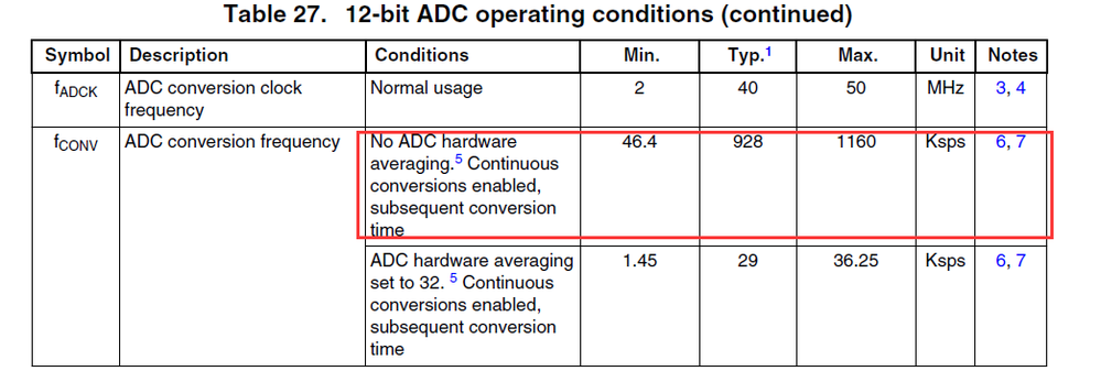

1. ADC sample time should be calculated to keep min value defined in the DS, which is 275ns. So with 48MHZ ADC clock it is 275ns*48MHz = 13.2. So set (14-1) into ADC inspector's sample time parameter.
2. the PBD timer should be properly set. Did you check what value is calculated for "delayValue"? It was 3, so you completely lost a precision for placing delay for PDB channel 1. So choose prescaler divider = 1 in both PDBs setting. This gives you better result for delayValue. Finaly set proper value for PDB channel 1 delay0 register, based on real ADC conversion time. I used below instructions to set a delay for 9us...
