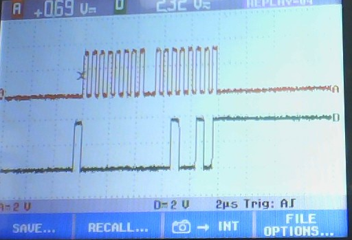

Hello all,
I'm using S32K146 and trying to receive data while communicating with the slave.
But, there is a difference in what actually on the scope & what I receiving the data?

My function includes transmitting 16 bits in 2 frames 8 bytes each with continuous transfer

The Image on the scope which shows Clock and MISO signals
But the data I received is 0x5B.
Kindly suggest me where I went wrong,

bjrajendra
Senior Contributor I
Hi Victor,
Thanks for the response.
In fact, I found a mistake with CPHA. Now I'm able to see the results as expected.

victorjimenez
Hello Raju,
Within the SDK for the S32K146 there's an example named "lpspi_transfer_s32k146". I recommend you check this example and use it as a guide to see how to configure and setup the LPSPI module.
