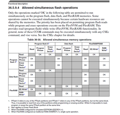

Thanks Julián.Besides,I ask a question:Can I place the "erase function "and "Write function" in the DFlash?
3,018 Views
Julián_AragónM
Hi @shiqi_seventeen,
You can refer to table 36.5.9.4 from the S32K1XX RM for allowed simultaneous flash operations:
Julián
