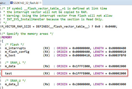

2.Modify the link file
Note 2 modified S32K142_32_flash.ld file
Note 3 modified S32K142_32_flash.ld file

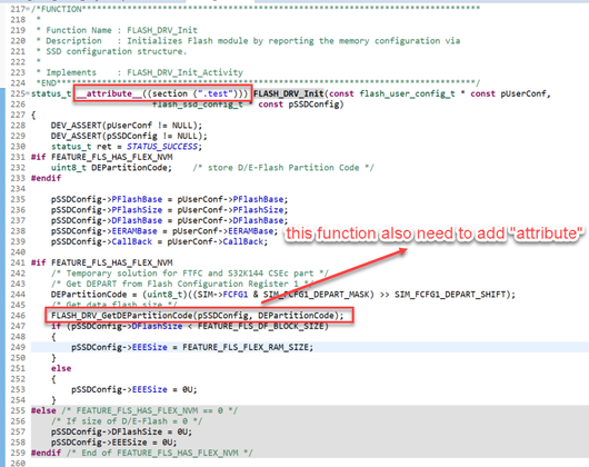

3.Add “attribute” commands for the functions necessary to operate flash
Note 4 add "attribute" to function,like this
      If another function is referenced in a function, then we also need to add “attribute” to the referenced function.

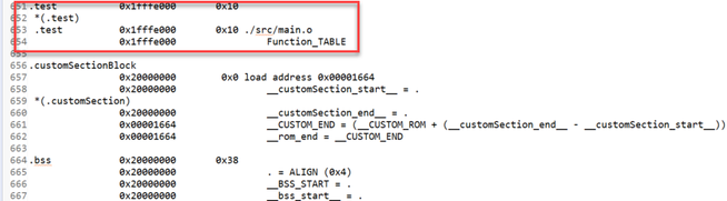

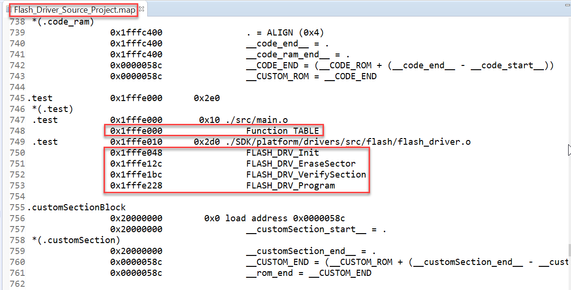

4.Compile the project and check the xx.map file to confirm whether the allocated address space is correct.
Note 5 check Flash_Driver_Source_Project.map

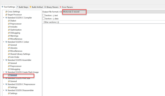

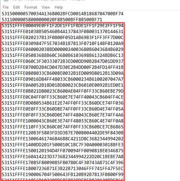

5.Make flash driver
Note 6 create flash image
Note 7 choose image format
Note 8 make flash driver image
      New a “xx.s19” file and then copy the data which range of 0x1fffe000~0x1ffffffff into this file

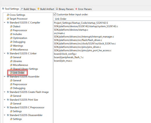

Note 9 change link order if necessary
      If some functions are distributed in different files, the function address allocated can be changed by changing the link order.

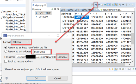

5.Enter debug section, import the prepared flash driver image.
Note 12 import flash driver image before operate flash module

你好,我按照你的方法去设置,但是他生成的map文件地址不对,如何修改链接文件的编译顺序?
