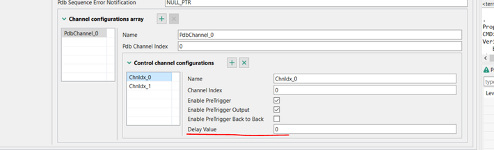

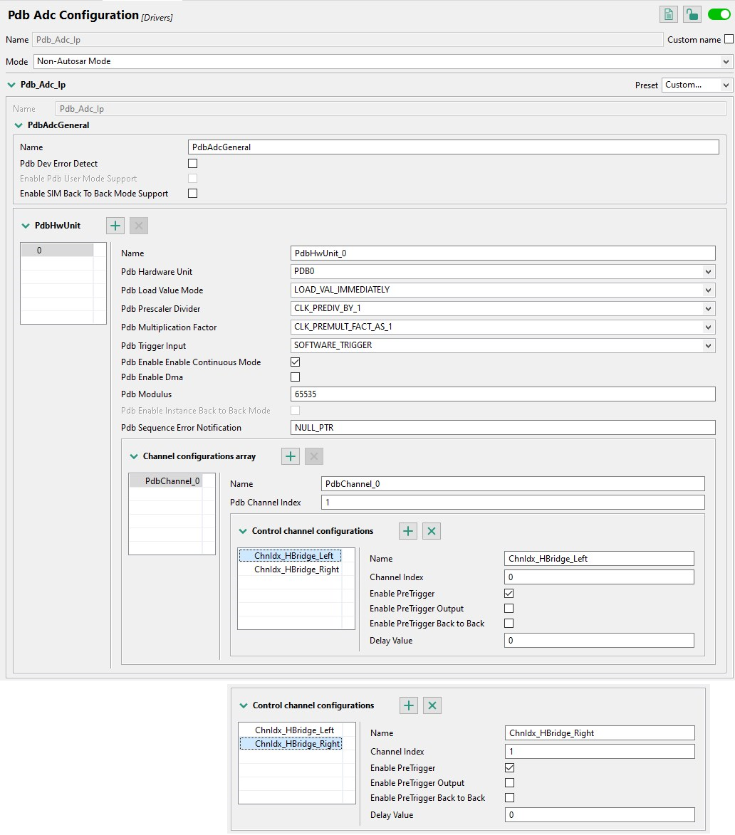

I create an ADC channel configurations array with PDB trigger-hardware.
But I get only an interrupt for (ControlChanIdx == 0).
I configured the system completely in RTD as you can see in the pictures.
Can you help me why there is no interrupt for (ControlChanIdx == 1)?

Hi@Micha4566465
This problem seems to be caused by setting the delay time of the two trigger channels to be the same.
You can try setting different delay parameters for the two pre-trigger channels.
