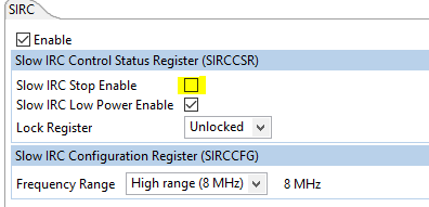

raresvasile
What is the observed current consumption?
One way to lower the value is to disable the SIRC in Stop modes.
The check box from the image has to be unchecked.
Please let me know the result.

raresvasile
1) The tab can be found in clock manager component. See the below picture
2) Please refer to the S32K1xx_Power_Modes_Configuration.xlsx attachment from the S32K Datasheet found in this location: https://www.nxp.com/docs/en/data-sheet/S32K-DS.pdf . You can take a look on the configurations for different power scenarios.

sureshjayagonda
Hi Rares,
How did u get to the window u put in the picture, i was not able to find that .
