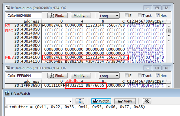

I also modified CAN examples to work in FIFO mode. It works, but I see unexpected data byte swapping/reversing in every 4 byte group on the receiving side in RX FIFO.
I send 8 bytes: 0,1,2,3,4,5,6,7.
In RX FIFO I see: 3,2,1,0,7,6,5,4.
Did you see anything like that with your code and board?
PS: I do not see that problem in normal mailbox mode (without FIFO).
My changes to the example project are very similar to yours, but I do not use loopback. I use another board to transmit instead.
Also noticed you have ".fd_enable = true" in SendCANData(), but maybe it is ignored by driver since module is not in FD mode.
Mikhail
15,558 Views

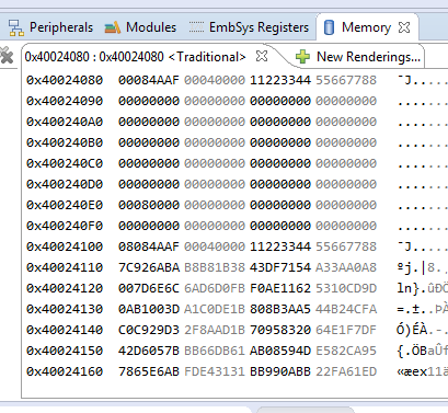

PetrS
Hi Mikhail,
The module itself does not do any byte swapping.
Seems the API itself does swapping. See how the receive buffer is filled from MBx or RXFIFO in functions FLEXCAN_HAL_ReadRxFifo() and FLEXCAN_HAL_GetMsgBuff().
Note the S32K144 is little endian device.
Here is a memory map when
uint8_t txBuffer[8] = {0x11,0x22,0x33,0x44,0x55,0x66,0x77,0x88};
is send with
SendCANData(TX_MAILBOX, TX_MSG_ID, &txBuffer[0], 8UL);
using the MB8
The debugger is stopped in FLEXCAN_DRV_IRQHandler, the RXFIFO is at address 0x40024080
I see no byte swap in RXFIFO. data from MB8 is received in the same order as it should.
The same memory window from S32DS
BR, Petr

mikhail_l
Hi Petr,
You are right!
In FLEXCAN_HAL_GetMsgBuff() they use REV_BYTES_32() to convert the data to little endian, but in FLEXCAN_HAL_ReadRxFifo() they do not do swapping and therefore data ends up being reversed.
Thanks!
