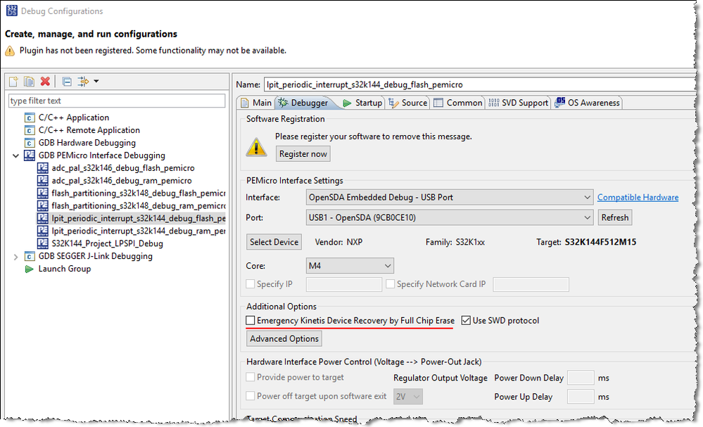

Have you check your source codes, if below debug pins are disabled by your software?
JTAG_TMS/SWD_DIO_PTA4
JTAG_TCLK/SWD_CLK
Have you try to select Emergency Kinetis Device Recovery by Full Chip Erase in debug configurations?

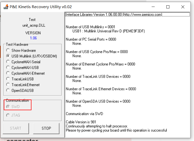

If still not work, please try to refer the P&E Recovery Utility described in "Bricking and Recovering FRDM-KL25Z Boards: Reset, SWD Clock and Low Power".

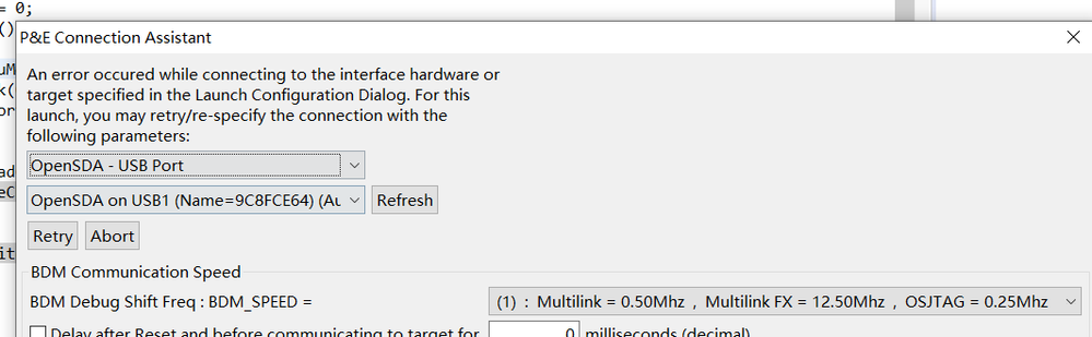

nieqi
Hi Robin:
   Thanks for you reply.
I try to select Emergency Kinetis Device Recovery by Full Chip Erase in debug configurations.It's not available. It's report a connetion error
My Borad Configuration is default state.
  I Read the Bricking and ercovering exsample.So I follow the exsample step by step.It's not working.My Recover Utility Can'nt choose SWD or JTAG.
Is any other way recover my S32K144EVB.
