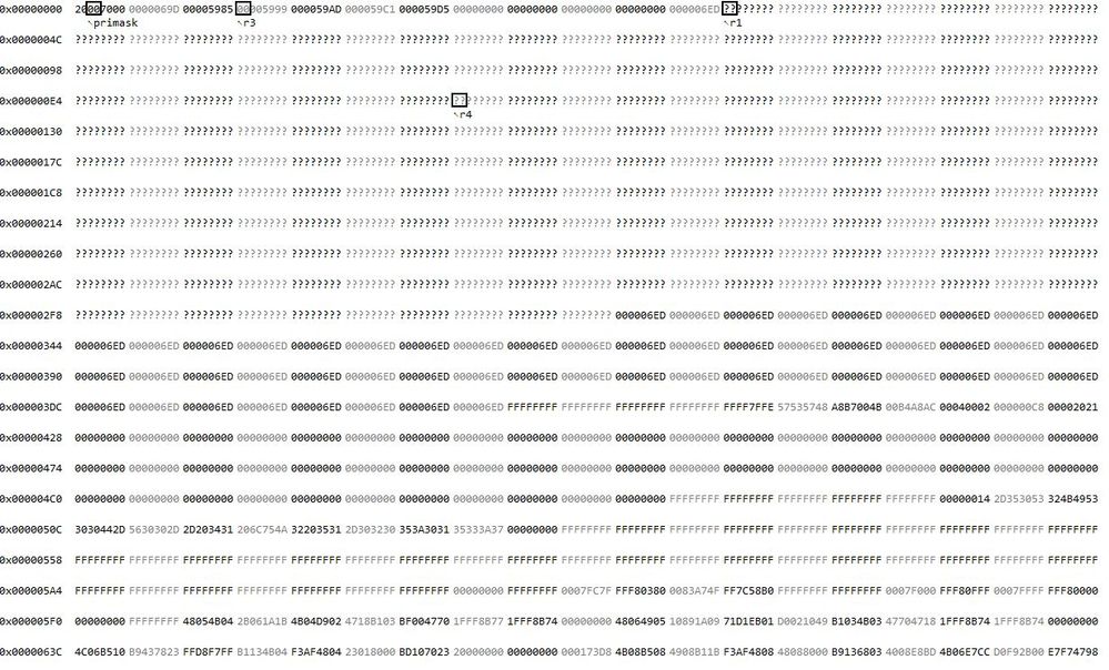

Hello Together,
i have some problems with a S32K144. I was able to debug and flash the device for quite some time.
I have prgrammed the S32K144 from a seond controller via SWD but I must done somting wrong.
Now it is not more posibble to connect the prozessor with debug interface.

It is possible to damage or lock the processor with wrong flash programming.
Sure that's possible. You can lock it by erasing the boot header.
You also have lots of ECC errors in flash, which can cause a lot of issues. Looks like your programming wasn't finish or done properly.
Is it possible to load any example code to the device?
Peter

koehlerl
yes it possible to load code to the device.
But the result is what you see in the last post in the memory browser.
Some flash is ok, but some regions have the problem with the error '?'
How can I 'repair' the fash?
BR Lutz

petervlna
You can simply reprogram (by any example code) flash or erase it via debugger or via application.
Have in mind to not leave empty boot vector at address 0x0 or the device will be locked.
best regards,
Peter

koehlerl
the problem ist, that the erase, reporgramming via debugger don't work correct.
Some memory regions have the problem with flash error. See meomery browser '?'.
So the application don't run. What must I do, that the flash is reprogrammed correct?
Lutz
7,874 Views
petervlna
Did you try it with PEMicro or Lauterbach? Or only via Segger? If you erase the memory from debugger, do you see success erase and the memory is still corrupt?
Do you see the issue on all devices or on just one?
You need to erase/program memory correctly to have matching data with ECC syndrome in memory.
best regards,
Peter

petervlna
Is it possible to attach to running target?
Try some example code instead of the current one. It is possible that your project is rewriting RAM where is Segger code, etc...
Could you try it with PEMicro?
best regards,
Peter
7,979 Views
koehlerl
It is possible to connet the target.
But it does not work.
There are wrong things in the memory?
It is possible to damge or lock the prozessor with wrong flash programming.
BR Lutz
