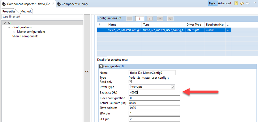

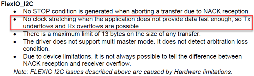

Hello Rodrigo,
In the S32 SDK Release Notes Version 3.0.0 pdf, you will find the following information about the FlexIO_I2C example.
When you turned off the optimizations you are making less effective the functions to receive and send information. Without the capability to do clock stretching, you are seeing that Tx underflows and Rx overflows occur. The correct way to avoid this to happen is to low the baudrate of the flexio_i2c_master. By default, the baudrate is 400000, if you modify this value for 40000, the project will work correctly even without optimizations because no clock stretching would be needed. You can make this modification with the help of Processor Expert.

rcortes
Thank you Victor for your help. Effectively, without optimization the project works with a smaller baud rate. I will have this in consideration for future developments.
