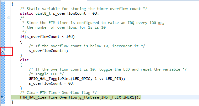

 I have a quesion, the platform is FRDM-S32K144/S32 Design Studio for ARM Version: 1.3/Win10,import ftm_periodic_interrupt example project from S32K144 RTM SDK v1.0.0 Example Projects,debug can,t run into the Flex Timer Instance interrupt service routine,please help ,thanks!

which breakpoints mark you see? If you see the same mark as is at the picture below, please click Run->Skip All Breakpoints
Correct mark of breakpoints is following:
Hope it helps.
Martin

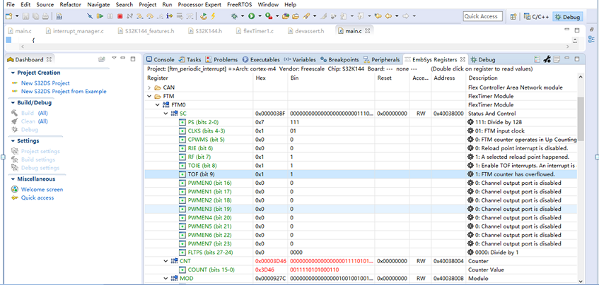

Add the breakpoint and debug rusult as follows
PS:FRDM-S32K144 CPU mask version is 0N77P ,which may affact the interrupt?

Hello Ray,
I can confirm that this example does not work correct with older microcontroller (mask 0N77P). If you want to use S32 Design Studio version 1.3 and SDK version 1.0.0 you must have board with the newest microcontroller (mask 0N47T). The older version of microcontroller is usable with S32 Design Studio version 1.2 only and with SDK 0.8.2.
