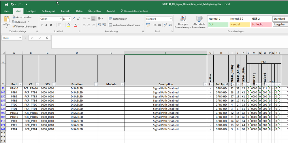

As per Device feature summary (Table 2-1), only high-drive pins are able to support 1 Mbps.
PTA2 and PTA3 are not high-drive pins. See IO Signal Description Input Multiplexing sheet(s) attached
to the RM.
5,921 Views
adrianwenger
Hi Daniel,
thank you for your reply.
After getting in touch with the IO Signal Description Input Multiplexing sheet i assume that,
if i use the PTB6 high-drive pin (LPI2C0_SDA) and the PTA3 (LPI2C0_SCL) i will be able to send with 1MBit/s to the i²C slave.
Is that correct?
Adrian
5,921 Views
danielmartynek
Hi Adrian,
The functionality at that rate is guaranteed (even with bus capacitance of 400pF) only using high-drive pins for both SDA, SCL.  If you use pins without high-drive capability, it might work in case the bus capacitance is not too high, but is not guaranteed.
