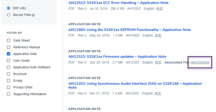

Hello team,
     I have 2 S32K144 EVB's, I want to perform firmware update using bootloader via CAN FD interface. But as per the document given for bootloader "AN12323", we have to create one memory partition application, one bootloader application and one more gateway application. But I cannot find any of the example application in the latest SDK's. Please help. Thanks

danielmartynek
Hi @vinaykl,
The AN comes with SW, but these are not SDK projects.
There is Unified Bootloader:
https://community.nxp.com/t5/S32K-Knowledge-Base/Unified-bootloader-Demo/ta-p/1423099
Built in S32DS R1 IDE with SDK RTM 2.0.0
It was discussed in this thread:
https://community.nxp.com/t5/S32K/OTA-using-UDS-over-the-CAN/td-p/1640549
