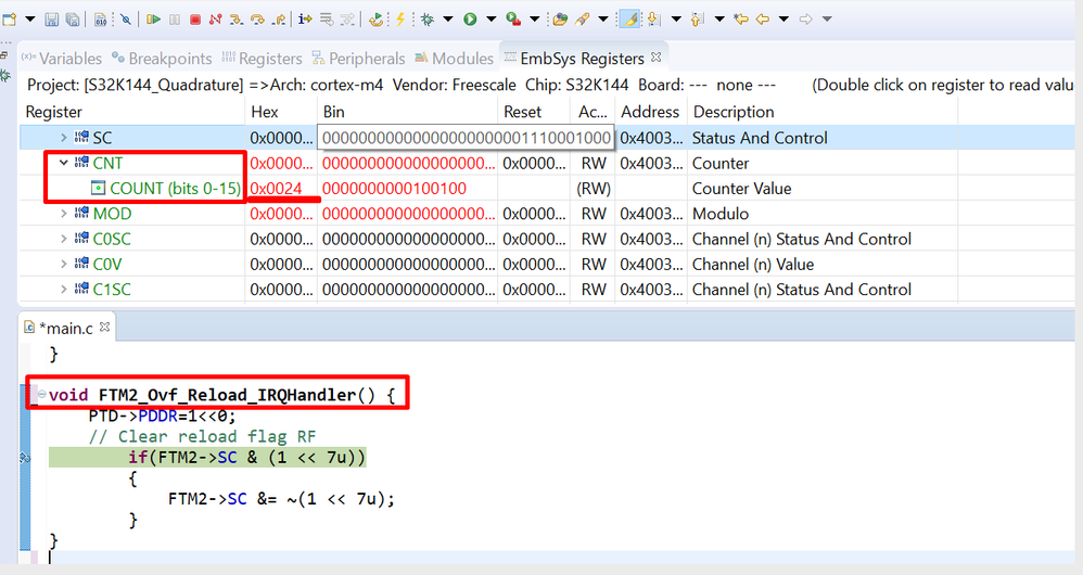

I have attached a very simple test code. I'm using S32K144EVB.
There I verify that after the FTM counter reach number 36 (0x24) the interrupt is generated.
I hope it helps.

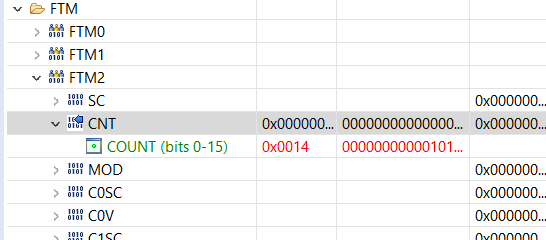

Thanks for your patience and kind help. Finally I figured it out and found the FTM2 should be configured to work under debug mode as I would like to debug it under the debug_RAM mode. So the following code must be added.
 FTM2->CONF = FTM_CONF_BDMMODE(3);
Under this way, the overflow interrrupt is set as follows:
Then, quadrature decoder works well and there is the same result as you attached. FTM2->CNT successfully changes.

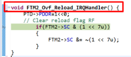

But here I have one more question. I used overflowed interrupt (TOF) but you suggested reload interrupt (RF) with the code as follows:
Interestingly, the output results are the same. Can you explain why this happen ?
6,176 Views
dianabatrlova
Hi Rong,
I'm very sorry for the delay. I'm glad that it works.
Actually I'm using TOIE - overflowed interrupt in this code. I'm using this code as a test code (it is not an official example) so, the clearing reload flag RF it's unnecessary. It should not be there. I'm sorry I confused you. There should be clearing TOF.
