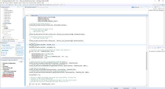

I got a little question about S32K FlexIO module.
I've check the S32K RM,and it says FlexIO only have 1 instance.
But it that possible to implement 2 different module by using FlexIO??
For example: PTA 0/1/2/3 implement FlexIO SPI module and PTD1 implement FlexIO PWM.
Thanks and Waiting for reply

Hi@Andy_Wang_JP
        Of course, there are already such routines in S32DS IDE. In this example, the FlexIO module is used to implement two-way I2S.
BR!
    Jim.

Hi @Senlent
Thanks~
I've used that to implement my project
