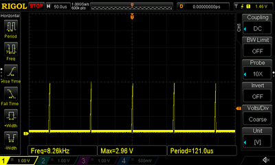

I have an issue with the reset line repetitivly being asserted between a S32K144 MCU and a FS2303 SBC.
In my design RSTB of the SBC is connected to PTA5 of the MCU with the recommended RC pull-up from the SBC datasheet:
(VDDIO = SBC V1 = 5V)
When reset reaches 3V, it gets pulled low to 0V and released after 120µs, in a repeating pattern:
Supply voltages all seem happy: 5V, 3.3V, 1.6V on SBC and 5V on the MCU.
Am I overlooking something, or what could be going on here?

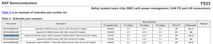

#FS32K144ULT0VLHT #MFS2303BMBA3EP

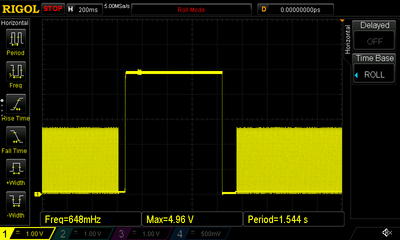

Robin_Shen
I mass erased S32K144EVB-Q100, and the reset pin signal is exactly the same as yours.
But when I use the connect command of J-Link Command or Target->Connect of J-Flash, the reset pin will no longer reset periodically, and the program can be downloaded.

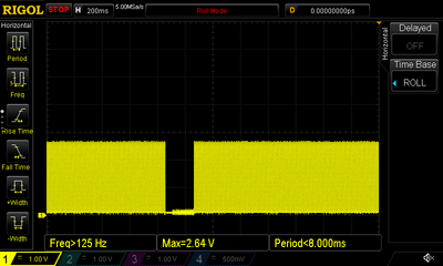

ThijsK
When I desolder the SBC and power the MCU directly with 5V, I do get the expected behavior you're also getting on the EVB:
So there is some interplay with the SBC, but what...

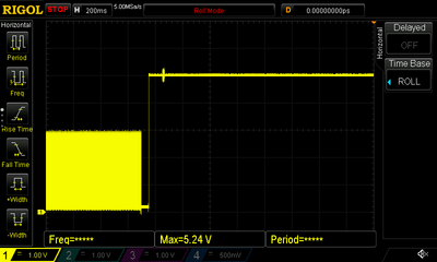

Robin_Shen
I only support S32K and I am not familiar with FS23 products.
But according to my experience, if FS23 does not enter debug mode, then you need to feed the watchdog. Since your S32K1 has not downloaded the program and cannot feed the watchdog, FS23 will generate a reset signal to reset the S32K1.
The circuit on the S32K3+FS23 board is designed to allow FS23 to enter debug mode (normal power supply but no need to feed the watchdog).
If it is in the design evaluation stage (the S32K1 program does not yet include FS23 configuration and feeding the watchdog), it is recommended to refer to the S32K3 board to design the debug mode circuit.
Note: This power-up procedure manages that FS23 SBC starts with a disabled watchdog:
https://www.nxp.com/document/guide/getting-started-with-the-s32k31xevb-q100-evaluation-board-for-gen...
Here is the schematic: S32K31XEVB-Q100 Evaluation Design Files
Please follow Figure 15. Debug mode.png to let the FS23 enter debug mode.
