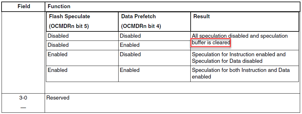

Regarding your answer marked with red on Q2, what is the mean of "buffer is cleared"?
It will execute 2 steps: 1. flush cache content to destination; 2. invalidate cache content
Is it right?
I am concerned about the valid content behavior in cache.
Liu

dsfire
Hello Victor,
Thanks for your information.
It's cleared to me for Q2.
For Q3.
