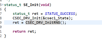

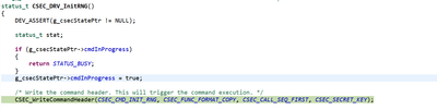

Hello, I am using the CSEc of the S32K144 chip. I use the S32K1xx CSEC Tool to generate an initialization binary file for the CSEc module, and download the initialization file into the S32K144 chip via J-link. Then I run my own program, and a Reset_Handler occurs at CSEC_DRV_InitRNG. Why is this happening? Did I set something wrong? The pictures below show some of my code and configurations.

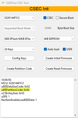

I did quick test on my board and it works as expected - I can enable CSEc by "Initial Firmware", then the CSEc works as expected and then I can reset the device by "Reset Firmware". But I noticed one difference: using the same configuration, DEPART is set 0x04 by the firmware. If I click on "Create Partition Code" in the tool, it is also showing 0x04:
But your screenshot shows that the DEPART is 0x08. It looks like the device is already partitioned but CSEc is not enabled.
I can see it's not explicitly mentioned in the user manual of the tool, but I supposed that it expects that the partition is not set when running "Initial Firmware".

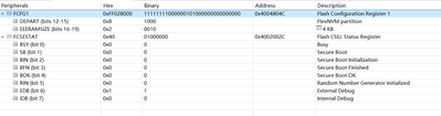

As you mentioned, I checked my FCFG1 register and FCSESTAT register, but their values showed no changes before the program entered the Reset_Handle 。According to the FCFG1 register, the EEPROM memory has been allocated. However, I executed the Reset program generated by the S32K1xx CSEc Tool (though it may not have executed successfully). From the FCSESTAT register, the status of CSEc remains "Busy", even though no operations are currently being performed on CSEc. What should I do to restore CSEc to normal?

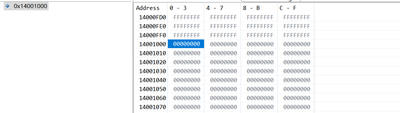

Hi @Jason88619
CSE PRAM is not writeable if the device is not partitioned and if CSEc is not enabled. This was discussed here, for example:
https://community.nxp.com/t5/S32K/CSE-PRAM-is-not-writable-S32K146/td-p/1282095
Was the InitFW loaded and executed successfully? What can you see in FCFG1 register in SIM module?

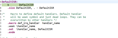

Jason88619
Inside the CSEC_DRV_InitRNG function, immediately after executing the line
/* Write the command header. This will trigger the command execution. */
CSEC_WriteCommandHeader(CSEC_CMD_INIT_RNG, CSEC_FUNC_FORMAT_COPY
/* Write the command header. This will trigger the command execution. */ CSEC_WriteCommandHeader(CSEC_CMD_INIT_RNG, CSEC_FUNC_FORMAT_COPY CSEC_CALL_SEQ_FIRST, CSEC_SECRET_KEY); the program enters DefaultISR.
2,833件の閲覧回数
lukaszadrapa
... and also please check FCSESTAT register in FTFC module.
