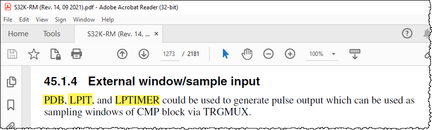

I use windowned mode, may I ask whether the windowned/sample signal is input by external pins, or by internal timer and other ways?
Sampled, Filtered (# 4A)mode Where do I input the external clock from?
Thanks.
1,595 Views
Robin_Shen
By those internal timer: PDB, LPIT, LPTIMER
