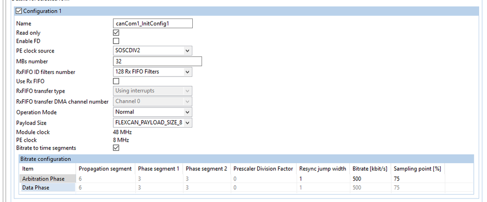

But I want to configure my CAN to receive from an unknown source. I'm facing issue there I have configured my CAN0 pins (E4 and E5) and connected these pins to external CAN transceiver. The CANH and CANL pins from transceiver is given to a CAN analyzer. I test with the CAN Analyzer to send and receive data to my controller. I'm successfully able to transfer data; but I'm not able to receive any. I have attached the snippets of the settings and code.

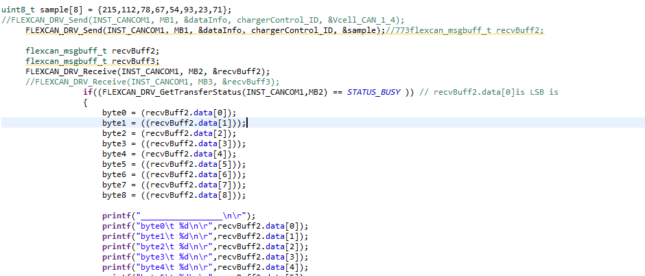

i observe that the MB2 is not getting updated, And i made the changes as if(FLEXCAN_DRV_GetTransferStatus(INST_CANCOM1, MB2) == STATUS_SUCCESS to print data

the configuration looks normal, so what does not work on RX side? MB2 is never updated with receive data?
Or do you see any errors detected on MCU and/or CAN tool?
Is the TX frame in the CAN tool defined to have standard or extended ID (0x123)?
The "dataInfo" in the code specifies if MB will accept std or ext ID, unless it is masked.
Also the usage of
if(FLEXCAN_DRV_GetTransferStatus(INST_CANCOM1, MB2) == STATUS_BUSY) is little bit weird.
Should not be there "while" instead of "if" to pass after MB2 receives a frame? or at least use
if(FLEXCAN_DRV_GetTransferStatus(INST_CANCOM1, MB2) == STATUS_SUCCESS to print data after MB2 is updated.
