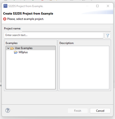

and Secondly when I look for Example projects the following is the view,
It seems something is missing in whole. Please help me in fixing the issue

Please ask on the S32 Design Studio forum about this issue.

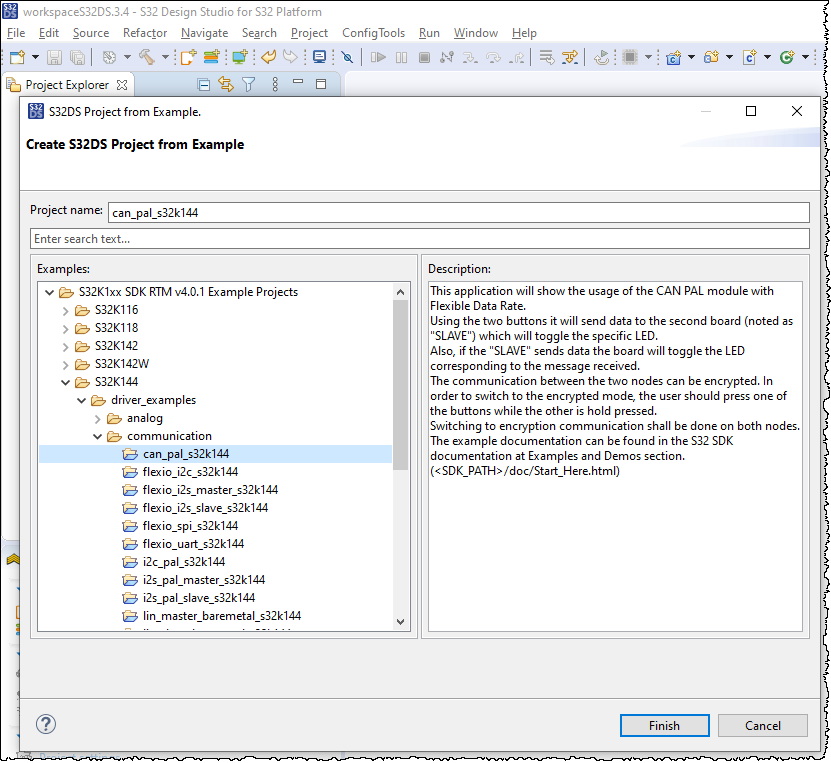

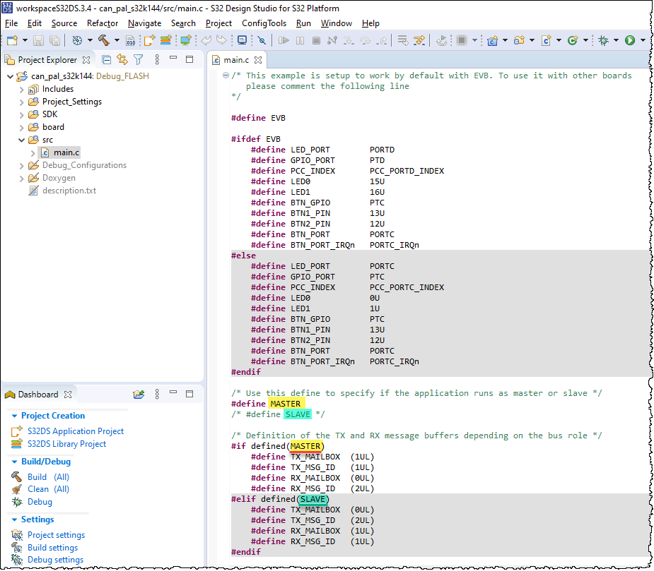

Hi yash_bhatnagar9,

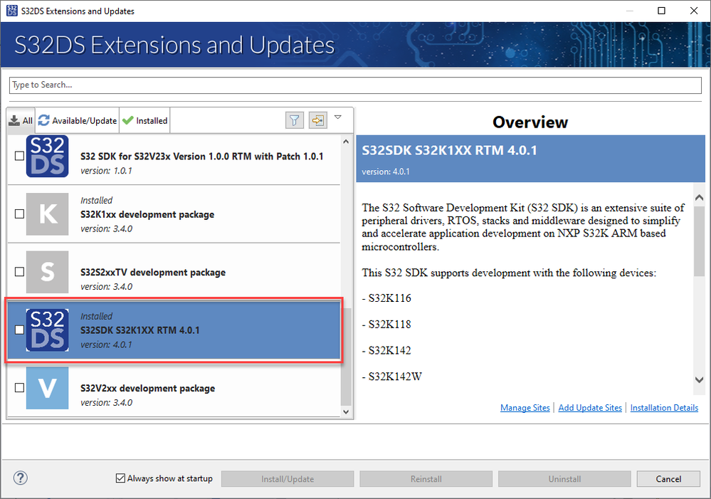

Please refer the can_pal_s32k144 example of S32SDK
You can download the S32 Design Studio 3.4 and then install the S32SDK S32K1XX RTM 4.0.1 in S32DS Extensions and Updates view.
can_pal_s32k144.pngcan_pal_s32k144.pngdefine MASTER SLAVE.pngdefine MASTER SLAVE.pngS32DS Extensions and Updates.pngS32DS Extensions and Updates.png
