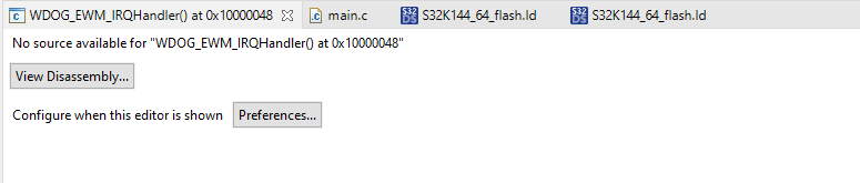

I'm getting warning as -> No source available for "WDOG_EWM_IRQHandler() at 0x10000048"

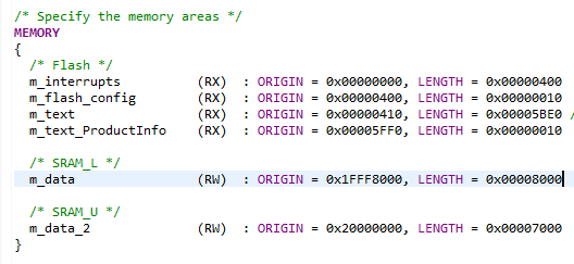

Memory configuration of Bootloader project:

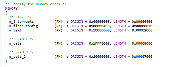

Memory configuration of Application project:mem err app.PNGmem err app.PNG
I want to ask why m_text region starts at address 0x10000000 in Linker file of Bootloader project? It must be 0x00000410? Is this is an error? Please correct me if I'm wrong.

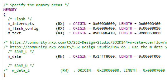

Application Memory mapping:

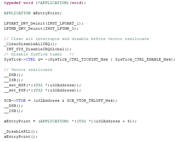

This is our code routine:
I am able to jump from bootloader to application using my code, but not able to jump from application to bootloader.
Please guide me with this.

What can you see in core registers when stepping over the jump instruction? I mean in asm, not in C. Is correct address loaded in the registers? Does it jump to the entry point? If yes, does it crash later in the application? Where?
Lukas

Hello @lukaszadrapa
Thank you for your response. I've checked core registers and now I'm able to jump to bootloader from firmware.

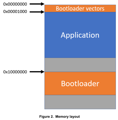

This is not original bootloader from application note AN12218, so we won't support this. It's just some modified version from another community user, not from NXP.
I recommend to start with original AN12218:
https://www.nxp.com/docs/en/application-note/AN12218.pdf
https://www.nxp.com/docs/en/application-note-software/AN12218SW.zip
The document also says, why data flash memory is used for the bootloader:
Another reason is that Read-While-Write is supported between the data flash and program flash, so it makes the bootloader simpler because it's not necessary to run the code from RAM during programming.
