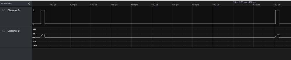

I have two S32K144 based boards that we've been working with for the past month and have flashed multiple times. We attempted to program a newly created image with a Cyclone programmer and both targets fail to boot after flash and we're unable to connect to them after the download.
Both targets appeared to program with the Cyclone but immediately after did not boot into the firmware as expected and we are unable to get a SWD connection to the boards using the Cyclone programmers, getting the error $00000007.
I've attempted to connect lowering the shift frequency and adding a delay after reset.
I've attempted to use the PE Micro Kinetis Recovery Tool with no success.
I'm not sure what caused the issues or how to recover. Any assistance isolating the cause and any potential recovery techniques would be appreciated.

Hello @lucianomoretti,
Can you please scope the reset_b pin (PTA5)?
Does the MCU keep resetting?
If so, what is the period of the reset events?
Do you use CSEc in the application?

lucianomoretti
Wow! Yes, the reset line is pulsing every ~113us without a debugger attached when powered up.
As far as I know the application does not use CSEc. It does use the D-Flash region as an emulated EEPROM.Reset Line.PNG

lucianomoretti
I scoped the reset line while trying to communicate with the debugger and while the probe is accessing the system the reset line remains low.

danielmartynek
Can you please connect the reset_b pin to VSS and power cycle the MCU so that the MCU can stay in reset after POR?
Then read the MDM-AP Status register and try the Unlock Kinetis command in J-link commander.
If the unlock command is successful, try loading an S32K144 example from the S32DS IDE.
