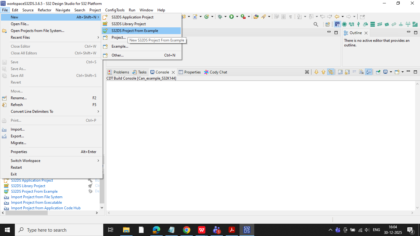

I am working with S32 Design Studio version 3.6.5 and using the S32K1 AUTOSAR 4.4 – RTD 3.0.0 (QLP02, D2505) package.
I tried to create and build the CAN example project provided in the RTD for MCU S32K144, targeting the S32K144EVB board.
Environment details:
  • Tool: S32 Design Studio 3.6.5
  • RTD: S32K1 AUTOSAR 4.4 RTD 3.0.0 (QLP02 D2505)
  • MCU: S32K144
  • Board: S32K144EVB-Q100
Steps followed:
  1. Imported the CAN example using “S32DS Project From Example”.
  2. Selected CAN0 related pins (TX/RX) using the configuration tool.
  3. Clicked Update Code.
  4. Tried to build the project.
Issue:
During compilation, I consistently get the following error:
./board/Port_Ci_Port_Ip_Cfg.h:47:10: fatal error: Port_Ci_Port_Ip_Types.h: No such file or directory #include "Port_Ci_Port_Ip_Types.h" compilation terminated. Building file: ../RTD/src/FlexCAN_Ip_Irq.c Invoking: Standard S32DS C Compiler
It looks like the Port IP AUTOSAR generated header file is missing, even after configuring CAN pins and updating the code.
