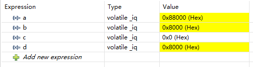

When using ammclib tool library for division calculation, the last 15 bit(bit14 --- bit0) results of each calculation are 0, and the actual accuracy is only 16 bit(bit30 --- bit15).

we added a new library function MLIB_DivSatAccurate_F32 in the AMMCLib release 1.1.26. This function calculates the division with full 32-bit accuracy of the result. The function is faster than 64-bit by 32-bit division (if you relied on compiler's optimization capabilities) but not as fast as MLIB_DivSat_F32.

420113461
What's the difference between the three versions of ammclib library? Will it improve the calculation accuracy?AMMCLIB.pngAMMCLIB.png
2,777 Views
lukaszadrapa
There's no difference. It just means if you have want to get object code for evaluation or if you want to buy a license for production (either object code only or full source code).
