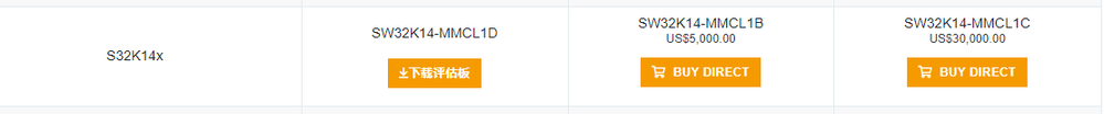

420113461
What's the difference between the three versions of ammclib library? Will it improve the calculation accuracy?AMMCLIB.pngAMMCLIB.png
2,772件の閲覧回数
lukaszadrapa
There's no difference. It just means if you have want to get object code for evaluation or if you want to buy a license for production (either object code only or full source code).
