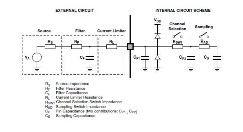

hello team,
we are using S32k144 uC in our designs.as per the datasheet shown below. no information about filter circuit and current limiting resistor.
 can you please confirm is it required filter circuit and current limiting resistor for ADC pins? if it is required can please provide the values of filter circuit and current limiting resistor?
959 Views
VaneB
Hi @mogilipuri_harish
This circuit is recommended but the values of the current limiter (RL) and filter block (RF and CF) are application dependent.
