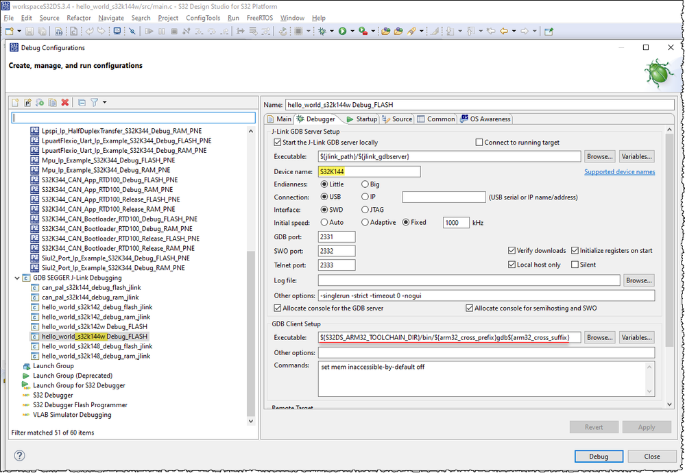

I don't have S32K142W chip on hand, so test it on S32K14WEVB-Q064 board(S32K144W_LQFP64). I am able to debug S32K144W when Device name input S32K144. Would you please import SDK example of S32K142W, and then input S32K142 as Device name?
Executable: ${S32DS_ARM32_TOOLCHAIN_DIR}/bin/${arm32_cross_prefix}gdb${arm32_cross_suffix}
I am using external SEGGER J-Link 10. Have you install the latest J-Link software?(You can consult SEGGER to confirm whether it supports S32K142W)J-Link debug S32K144W select S32K144.pngJ-Link debug S32K144W select S32K144.png

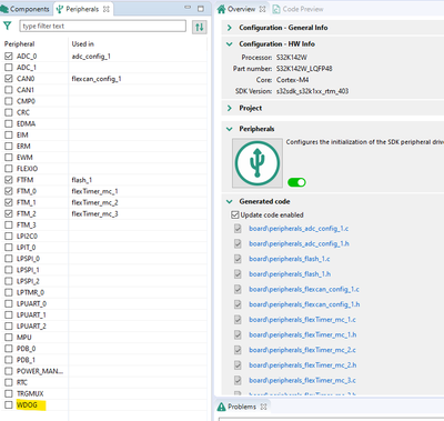

also.. the watchdog is NOT  initialized, or otherwise enabled.

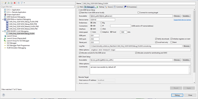

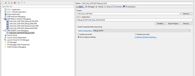

This is how the debugger is set up.

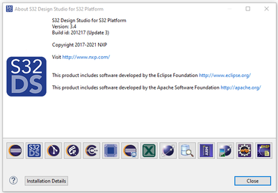

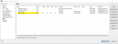

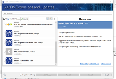

The S32DS version I was using was 3.4 and I had S32DK S32K1XX RTM 4.0.3 installed.
I also downloaded the newer S32K 3.5 but interestingly it only shows S32DK S32K1X RTM 4.0.1
Which should I be using or does it matter?

Currently, users who develop S32K1 please use S32DS 3.4. I can see that the S32K1 RTD and SDK are both installed. Have you tried to test the RTD and SDK example?(File->New->S32DS Project from Example)

Please download the S32DS v3.4 and install the S32 SDK for S32K1xx RTM 4.0.2. S32K142W and S32K144W is in the support list of it. Do not develop S32K14xW with old S32DS and SDK, there are some difference between S32K142 and S32K142W which may cause hardfault and crash.
