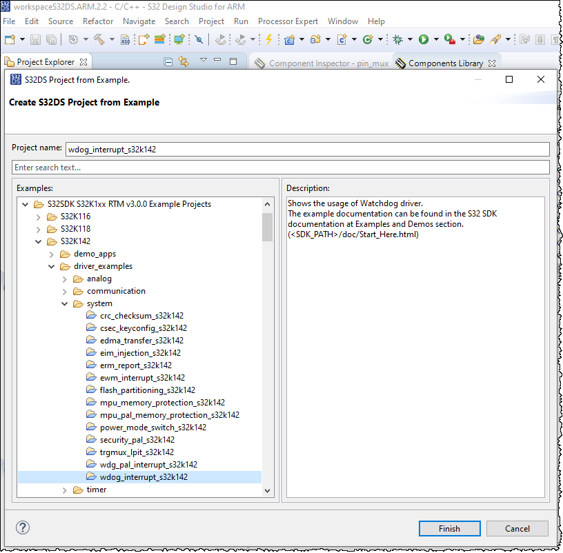

Hi,all
I want to use the wdog,but when I init it ,it stops in
"while(((WDOG->CS & WDOG_CS_ULK_MASK)) == 0);"
What should I check to solve it?

I have solved the problem, the hardware changes the Crystal oscillator, the input clock selects the SIRC,it works.

Hi Ada_Lovelace,
Maybe you can refer the codes in S32SDK example wdog_interrupt_s32k142
Robin
