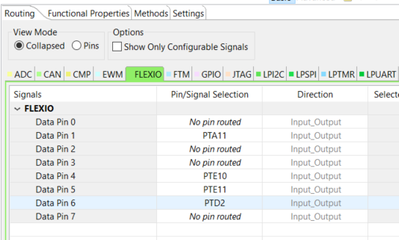

2.1 PinSettings:
2.2 FlexIO spi configuration

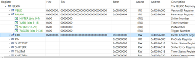

when I debug to FLEXIO_SPI_DRV_MasterInit-->FLEXIO_DRV_InitDriver-->FLEXIO_DRV_Allocate
FLEXIO_DRV_Allocate is always return ERROR. Regiater PARAM is all zero, It seems no shifter and timer resource is available for my configuration.

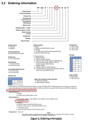

It looks like you have old version of the chip. The 'R' in the part number means (FS32K142URT0VLH LQFP64) that it's device with "Basic feature set" only without FlexIO. This version is not offered anymore:
So, my recommendation is to order new device. As you can see in the screenshot above, all current devices have FlexIO available now (see Y: Optional feature).

lukaszadrapa
Hi @AndyChen1
the most interesting information is that PARAM is always zero. Could you write down whole part number of your device?
Lukas
3,629 Views
AndyChen1
Hello @lukaszadrapa
whole part number is FS32K142URT0VLH LQFP64
I saw PARAM reset value is 0x04080404,
when I double click register name, the value read back is 0x0000000.
Is there any operation mistake or something I mis-understand?

lukaszadrapa
