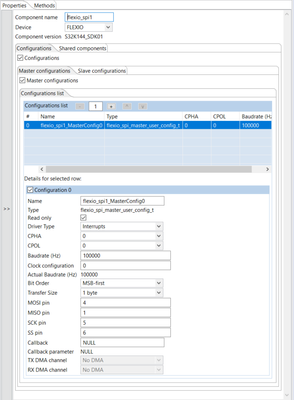

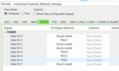

2.1 PinSettings:
2.2 FlexIO spi configuration
3. Code implementaion:
flexio_device_state_t flexIODeviceState;
flexio_spi_master_state_t flexIOSPIState_Master;
FLEXIO_DRV_InitDevice(INST_FLEXIO_SPI1, &flexIODeviceState);
FLEXIO_SPI_DRV_MasterInit(INST_FLEXIO_SPI1, &flexio_spi1_MasterConfig0, &flexIOSPIState_Master);
