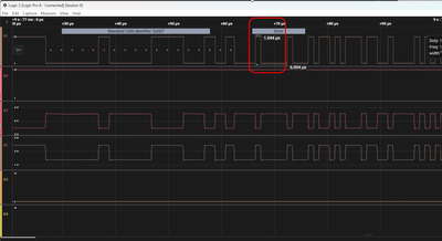

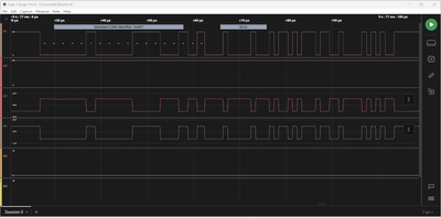

   We try to test the Can bus Tx part of can_pal sample code,
The system configuration of can bus is the same as previous and bit rate setting is the same as sample code (500kbps).
The smallest preiod of Tx signal is about 2us,  if the data is sent by using can emulator.
We found the smallest period seems 1us, when can bus signal sent by EVB.
During this time, LA has detect an signal error.
Fig. 1 is the overall signals of can bus.
Fig1.a and Fig. 1.b are the zoom in of leftside and rightside parts of Fig.1, respectively.
We found the signal of Fig. 1.b has 1 us period, marked by red rectangule.
We just modify the define of TX_MSG_ID, Rx_MSG_ID, and disable the CAN_Receive() function form the can_pal sample code,
we also put this test code in the attachment.
Could you help us to take care this iisue.
Fig. 1, Can bus signal measured by LA,
Fig. 1.a, Can bus signal issuzed by Can emulator,
Fig 1.b Can bus signal issuzed by S32K118 EVB

I have not installed S32K1 SDK RTM4.0.1 in S32DS v3.5, so I cannot open your project. But the can_pal_s32k118 in SDK RTM 4.0.3 enable CAN FD(flexible data rate) by default. And Bitrate of Data Phase is 1000kbit/s.
can_pal_s32k118_SDK403 Enable flexible data rate.pngcan_pal_s32k118_SDK403 Enable flexible data rate.pngDoes your can emulator support CAN FD? If it is not supported, it is recommended to modify the project to disable CAN FD.
By the way, it is recommended to use the latest SDK, because the new version fixes the bug that has been discovered.
