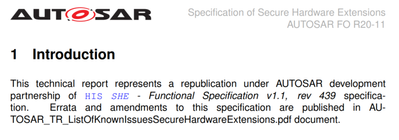

S32K146 CSEC RAM_KEY_ID = 0xF , But what the standard defines is 0xE,This is why?
The standard documentation is shown below:

lukaszadrapa
OK, it seems to be a mistake. But all our drivers take this into consideration, so it should be no problem.
Lukas

lukaszadrapa
Hi @1260784871
that's a good question, I have never noticed that before. I will try to ask if there's a reason for this but it looks like mistake only.
