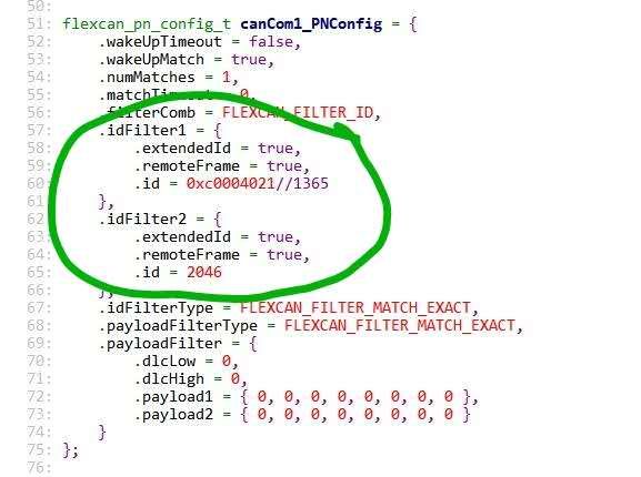

Hi, Is there a CAN extension frame example based on S32k family mcus (preferably S32K118) ?
Or help guide how to use the SDK modification?
For example, the destination address and the original address in the extension frame, how are these configured?
How are these two filters chosen? Is that ID the source and destination address for configuring the extension frame?
1,914 Views
PetrS
this settings belongs to Pretended Networking functionality used in low power mode.
To send/receive extended frames message buffer setting is done within code.
