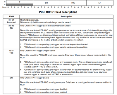

first pretrigger must use delay, either small one or delay can be bypassed (specified by CHnC1[TOS] bit), but cannot have back-to-back option (CHnC1[BB] bit) set otherwise will not be triggered.
SW trigger just start PDB counter.
if BB is set then TOS is going to be ignored.
So your setting for pretriggers in back-to-back chain can be
- all have Enable the pre-trigger option set (EN bit), Enable pre-trigger output unchecked (TOS bit)
- enable pre-trigger back-to-back mode for all except first one
BR, Petr
BR, Petr
